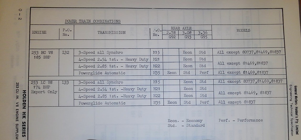

Here is the answer to question 1. Pictures tell the story, remember HK only had one model per body/lux level. Whereas as HT had two models per body/lux level - example Belmont sedan 80169 and V8 Belmont sedan 80269. So with 253 planned for release with HK coupes, the 253 was an optional engine whereas in HT-HQ it was always the standard engine in most V8 models. So it needed an RPO code and L32 was given. Otherwise it would never have been given an RPO code until LH Torana. An example of no code is I believe the LC GTR 2600S and 2850S.
You will also notice a few things there in the PTC's that never did happen. Like M22 behind V8. And the planned use of a 6cyl grey iron banjo centre behind a V8 - that never happened either. The V8 banjos were always the stronger nodular 2.78 and 3.08. 3.08 became the standard 253/4.2 manual rear axle ratio for a Holden until HX (but was a Salisbury for HQ and HJ). And 2.78 became the 253 auto ratio until GMH retired the 2.78 Salisbury around the end of HJ.
Edited by user Friday, 5 December 2025 7:57:38 AM(UTC)  | Reason: Not specified

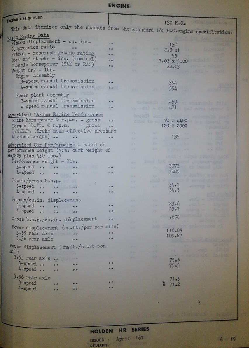

On the same topic I just recently found out that GM-H used the little 130ci Red motor (2150 - not 2250/138) in the HR series. It was P.O. 636 in the HR & then L22 for HK/T/G/Q & LC/LJ I know that the engine no. prefix is 130E for HK/T/G & 130T for early LC. Late LC & LJ was CA, while HQ was QA.
My question is, what is the engine number prefix for the HR.
Edited by user Friday, 5 December 2025 3:20:08 PM(UTC)  | Reason: Not specified
#7 Posted : Friday, 5 December 2025 3:45:10 PM(UTC)
Yes Terry, option 636. Only available as RHD, Export only and manual only. Only available on 215, 225, 219 and 229. There is nothing in the HR Eng Tech Specs that spells out its engine number prefix.
Here is where it was added to the Eng Tech Specs:
