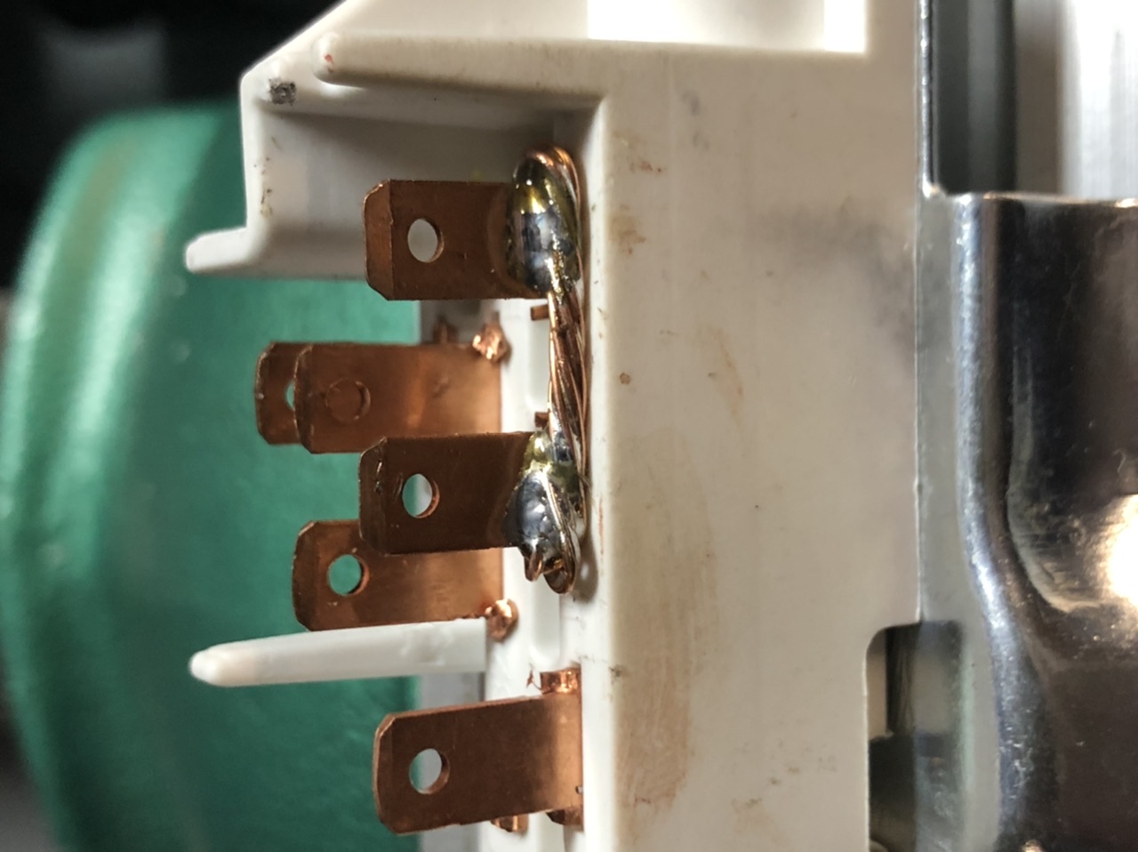

I'll post up a photo later of the mod to make to the ignition switch. Easy conversion.

I'll attach an image of the modified ignition switch too:
Bridge pins 11 and 12.
Wiring diagram shows you why. Gives full 12V to the coil always.
