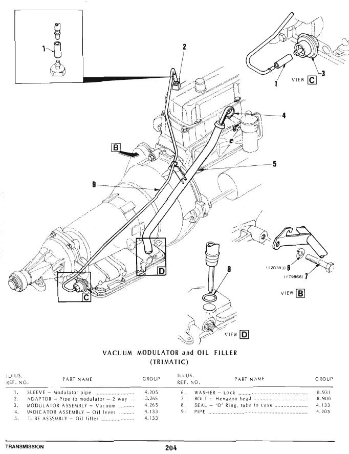

Hi all
Would anyone have a photo or 2 of the correct routing of the steel vacuum line on a V8 Trimatic & also the clips / brackets required to afix same to the transmission.
HJ 1 Tonner if that makes a difference
Thanks again in advance

Best I can do. HJ parts book.

perfect thankyou

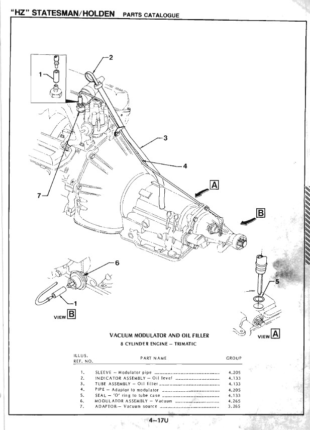

Anyone got the V8 version of this ?
TIA

Courtesy of Dr Terry. This is HZ but pretty close. The only difference with the HJ book is it gives a close up of the tube attachment under the bellhousing bolt.

Thanks again
