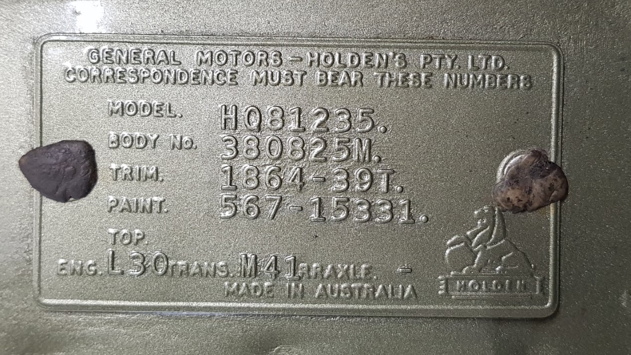

Only Ewe’t myself. This guy was trying to sell his 350 powered HQ ute as a “factory 350”. I finally convinced him to send me photos of the tags and they were quick to show that this was not the case. Waiting for a sucker i guess.
#6 Posted : Tuesday, 17 September 2024 5:57:09 PM(UTC)
You would never pick a HQ 350 ute from tags unless it was a late one. Same with LS and Premier, even Monaro. Same way you couldn't pick a standard V8 one from one optioned with a 308.
I have tag images from the other Dandenong L30 optioned HQ Kingswood V8 ute, it was Chateau Mauve and a bench seat so column shift M41. This is the one that wasn't the Ewe't. I've also seen the tags for Bob Jane's HQ V8 Premier wagon that was optioned with L30, it was Sebring Orange so a CTV car as well. Both of those cars you would not know anything about them mechanically except they were at least a 253, and both autos as they had ADR9 on the compliance plate. The only way I know they were L30 M41 cars was I saw them in the Service/Warranty records.

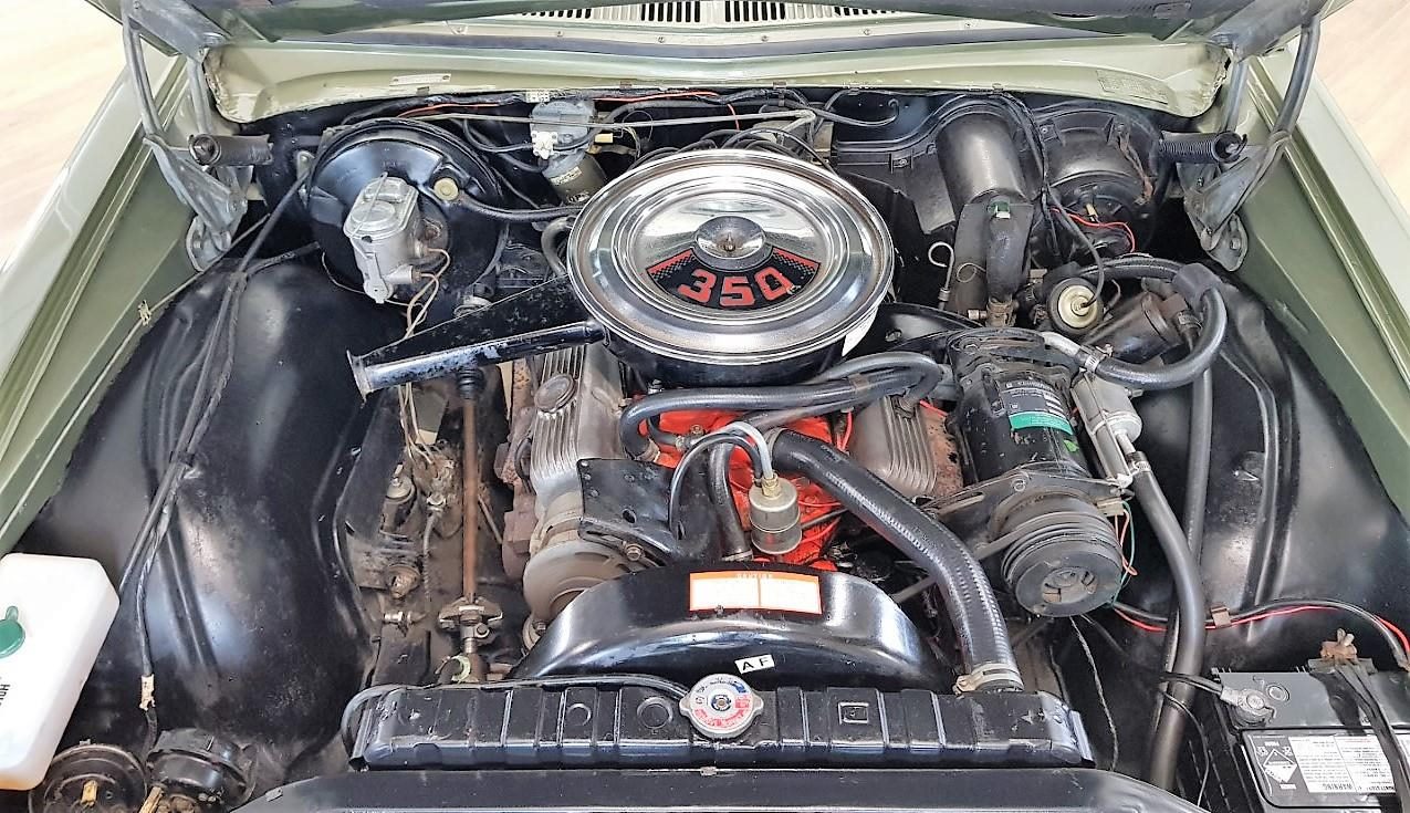

WagonDan Offline
#7 Posted : Wednesday, 18 September 2024 3:57:48 PM(UTC)
WagonDan
Joined: 24/11/2021(UTC)
Posts: 56
Location: Auckland
Thanks: 4 times
Here ya go. 1 of the L30 optioned Premier Wagon's 🙂
#8 Posted : Wednesday, 18 September 2024 5:32:13 PM(UTC)
A Preston motors (Dandenong) car, had power steering as well. Influential Dealer.
WagonDan Offline
#9 Posted : Wednesday, 18 September 2024 7:05:14 PM(UTC)
WagonDan
Posts: 56
Location: Auckland
Thanks: 4 times
It is Power Steering equipped Yes, and has had AirCon fitted at a later date (I believe).
#10 Posted : Wednesday, 18 September 2024 9:29:47 PM(UTC)
Aircon isn’t original by its BETSBAC.
