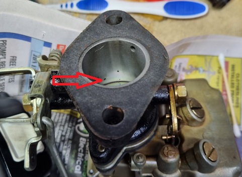

Pulled the carb off today and the distributor vacuum port is definitely well below the throttle plate (indicated by red arrow).
But I am a bit confused after checking my parts manual. It indicates that all EH and HD 149 carbs had the same carb base. And all EH and HD 179 carbs had the same base. Regardless of auto or manual:
So now I'm wondering if the bases used for these carbs had manifold vacuum or ported vacuum for the distributor connection (and whether mine is suitable for my manual car).
Rgds,

#15 Posted : Sunday, 7 July 2024 9:58:16 AM(UTC)
It is confusing & yes you are correct the carby bases were the same for M/T & A/T before Nov 1965.
To my knowledge the vacuum port in the early cars was a compromise where the vacuum came in very early & so early in fact with the an A/T in drive, the dissy saw 'some' vacuum which is why they say to remove the hose & block it off when setting base timing.
From Nov 1965 onwards they made a clear distinction between the M/T & A/T vacuum setups. With full vacuum it results in a more stable idle in drive, this in not required for an M/T.
I think what you have there is a late A/T carby base. Find an M/T base if you have an M/T.
Getting back to your original dramas, none of this will result in sooty black spark plugs.
