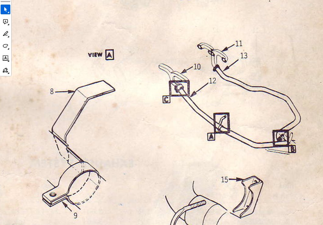

A forum member sent me this. Item 13 is the V8 RH pipe you have.
WagonDan on 8/02/2024(UTC)

Well there's the proof, thanks very much!
