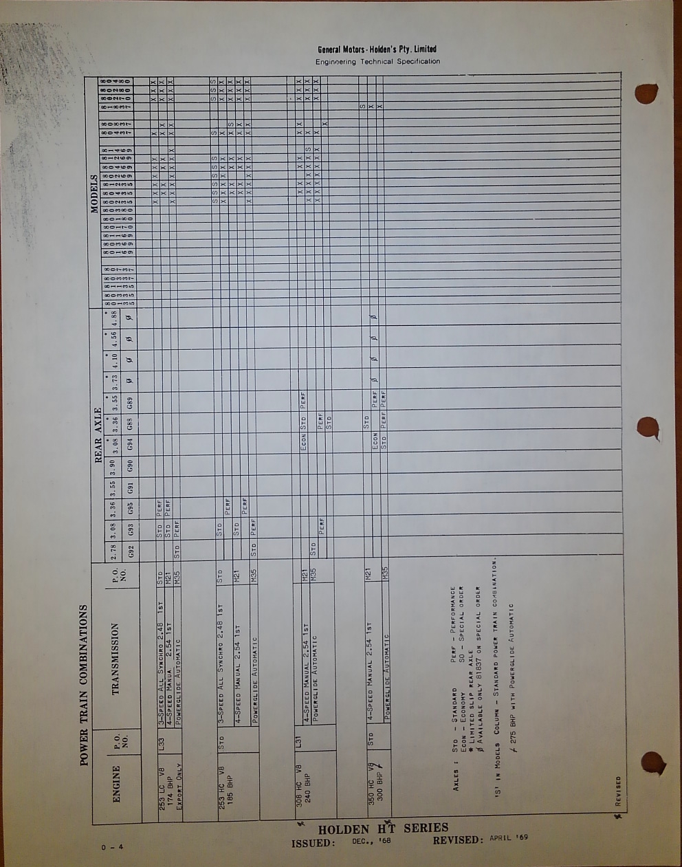

I think the HG parts catalogue was published but never amended and it was based on an early HT catalogue not the revised one. Remember that 308 was only available as auto and in Brougham at HT release. By the time the HT parts catalogues were amended for 308 manual HG would have already been well and truly being locked in.
Here is the Eng Tech Spec revision notice.
Here is where it was removed from the driveline combos. See the blank line against 308?
I can also confirm in all of the Pilot HT's (I have all of them listed) there are no 308 3spd manuals. These were built between February and April 1969. There are 253 Powerglides, and 253 4spd with 3.36 banjo rear axles (not sure how that happened as there were no V8 grey iron banjos and thus only 2.78 and 3.08 V8 banjos).
