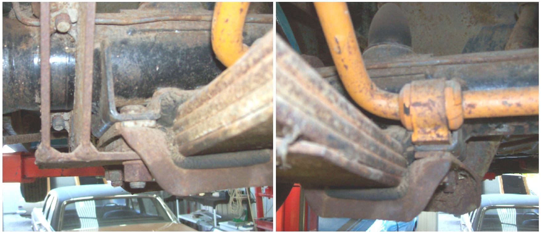

I have a question on Radius Rod spacers.
I'm questioning the position of the 4 spacers installed on each side of the mounting plate. (spacers where uninstalled from either side) There's no reason for the inner side to be installed, or is it there for strength? Spacers are 0.25in 6.35mm [img]null[/img]thick, do I double these spacers on the outer sides?
The HK Shop Manual Supplement does not show 4 spacers but 2 spacers only and they look thicker than 0.25in. Yes pics can be deceiving.
Anyone have a early Sydney built car they can refer to.

Theres a single spacer ON TOP of each side of the lower bracket.
Theres two spacers UNDER one side of the lower bracket.
Did you stack three spacers on top of eachother?
