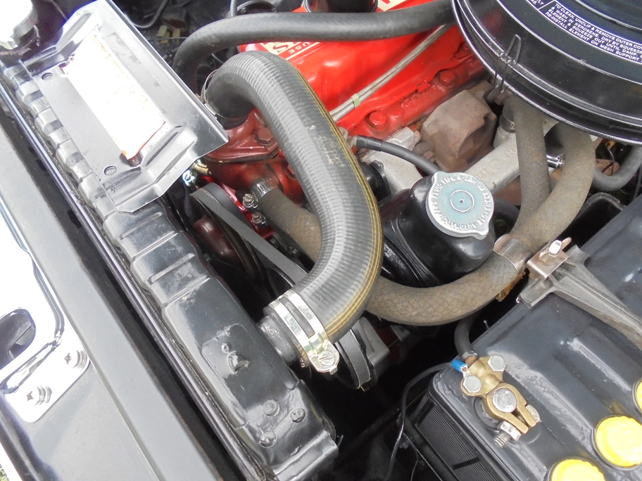

Yep, that's totally correct. Here are 3 different HR's (although not X2 or S) with PowerSteer and the EH style top thermostat housing 👍
I'm sure your aware that's a very rare item you have there. I was unable to source that hose, either NOS or New, when fitting Powersteer to my HR X2.
Out of curiosity, does your hose have yellow lines running the length of it, like the hose pictured?
I would be interested to see your Intake manifold water hose setup.
186S w/Power Steer had their own hoses, due to the immediate 90 degree bend out of the lower thermostat housing (to clear the powersteer pump) and for the specific setup of the 186S intake manifold.
