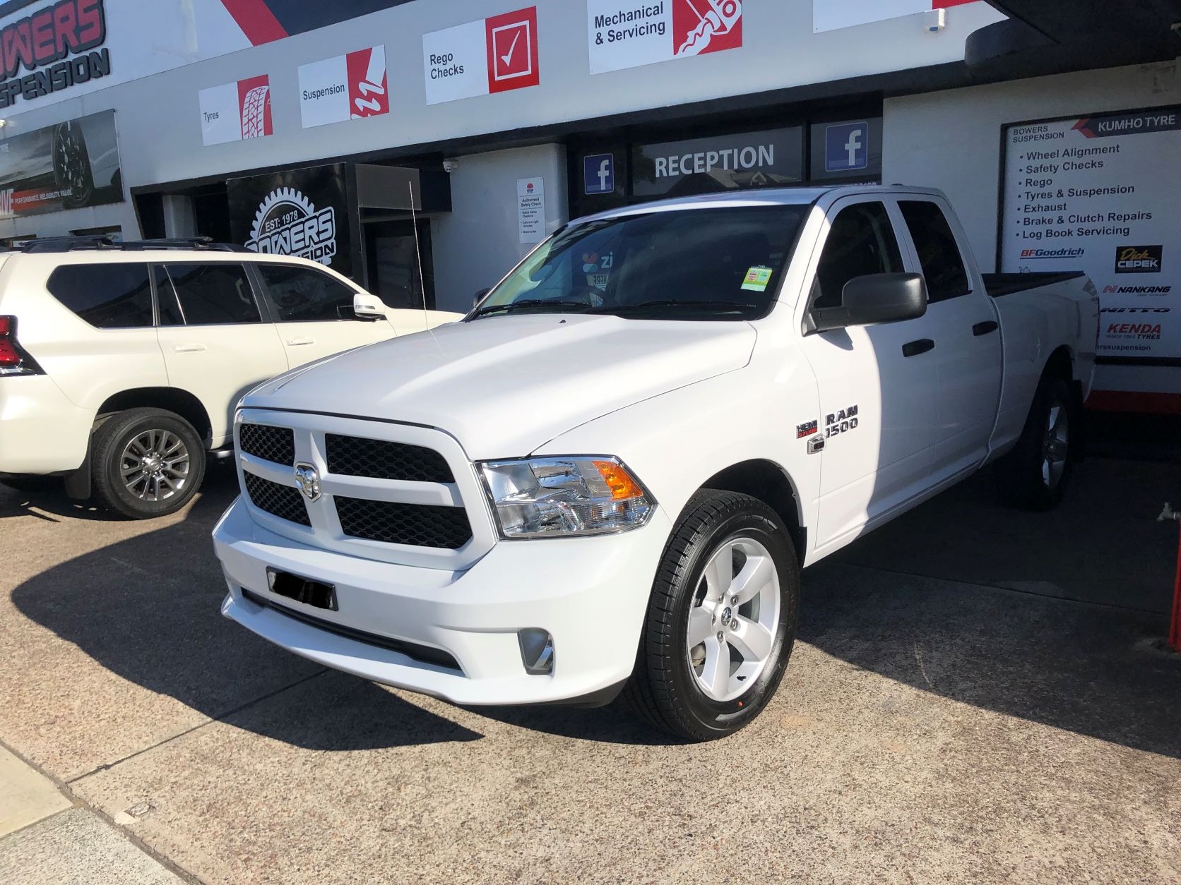

The day I bought mine it went straight in for a suspension upgrade and rear air bags, plus took the 20" wheels and their 265/60/20 tyres off. I fitted 18x9 rims with the same offset as the 20" with 295/70/18 tyres. The next day it went on the dyno to see what the speedo was like so I could get into the BCM and fix it, but it read spot on with the chassis dyno at 20, 20, 60, 80, 100 and 120. So no need to fix it! The new tyres are 38mm taller than the originals.

Mine had maybe 30kM on it when the originals were taken off! I fitted these rims:
http://murchisonproducts...acy-wheel-18x9-18-offset
And these tyres:
https://www.tyroola.com....QlwLQjeQt24aAr3aEALw_wcB
I did look at the same 295/70/18 tyre in that Maxxix you bought but these Yokos were on special and they had a buy 3 get 4 deal on, so they were less than $290 a tyre.
The reason I went for 18" is I wanted a sidewall. Already I have bounded off lots of kerbs maneuvering through shopping centre carparks and drive thru coffee and the bigger sidewall protects the rims.
The Toyos on that wheel image above at Murchison are what I really wanted but they aren't available in Australia in a 295/70/18. The ones in that picture are 35x12.5R18 which aren't legal as they are more than 50mm taller than the originals. Once Toyo release the AT3 in Australia I'll be able to get the 295/70/18 tyres. The 35" tyres are 890mm, the 295/70/18 are 870mm and are already 38mm taller than the original 265/60/20.
Here is how it looked, before and when I picked it up after the suspension and wheels/tyres were done.
