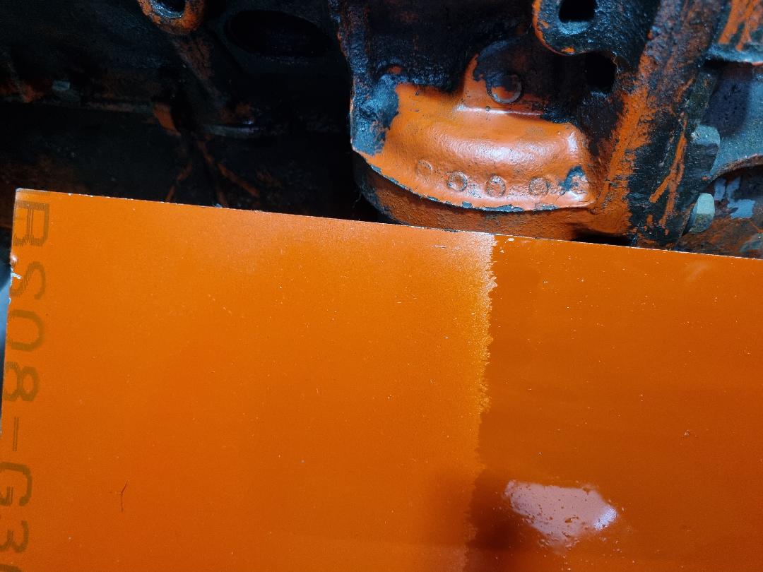

Today I went and purchased a can of Chevrolet Orange/Red for some comparisons. We must be mindful of whether or not the Chevrolet Orange/Red is a true depiction of the colours used in the 1960's without an original paint example it is impossible to be sure. One thing is for sure, the Duplicolor Chevrolet Orange DE1620 is about as close a match if not exact to the colour of my original paint HK GTS 327 Type 1 engine Pagewood built car.
The Chevrolet Orange/Red is a a much more pastel matt finish almost like a red primer consistency. I have attached some pictures for comparison below.
The whole reason for this excercise is to give some confidence to restorers of what may or may not constitute a correct colour for a HK Type 1 GTS 327 Engine, or any other engine that came out of the US during the same period which also may or may not include HK Type2 GTS 327 which will require further evidence.
So in short in my view and based on my research and the photos attached if you paint your HK GTS 327 Type 1 engine in Duplicolor Chevrolet Orange DE1620 it should be correct for the time period for both judging if you are that way inclined and personal confidence that you are doing the right thing.
It would be great to compare both of these colours against an Holden X2 Holden Red. I have attached some pictures below of what I think is the same product being spruiked on Ebay as "NEW CORRECT HOLDEN ENGINE PAINT TO HD X2 HR X2 HR 186S 179 X2 186 X2 MOTOSPRAY", it shows the colour difference as I painted the top of the Oil Filler Tube with this so called X2 paint.

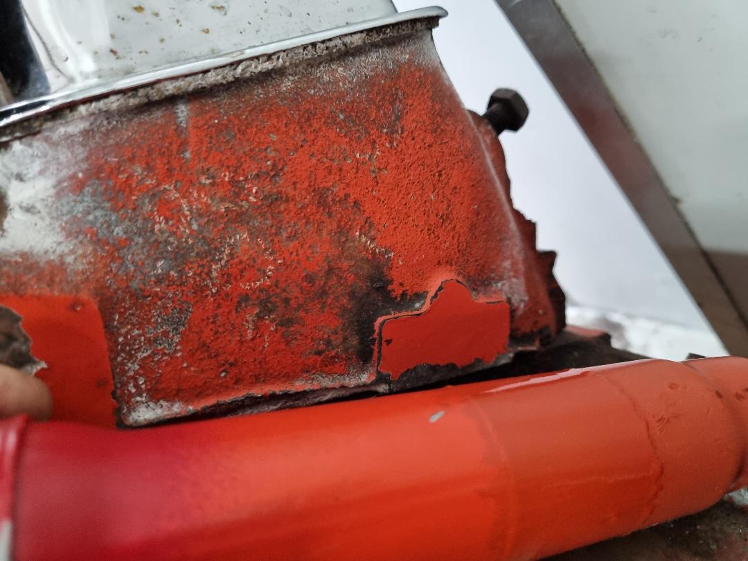

Below is a few pics sent to me today off a HK 307, apparently they sat in a boot of a car for decades, can't verify them as original paint but they sure look consistent with age, and it is a good reference point because who would have bothered to paint them after the factory back in he day. This slavish pedanticism of painting every little detail correct, getting every clip right, and checking every bolt for the right marking is a modern phenomenon.
On another note would it make sense that they installed the gearboxes and did all the linkage adjustments in the USA and Canada on Australian export 327 engines as well? Now this is speculative but could it be possible that they painted entire assemblies (Engine,Gearbox and Bellhousing) for export engines?
If not at what point were the gearboxes and linkage installed. If HK production was not body dropped then the linkages on the gearboxes would have been a pain and prone to damage during installation, especially with HK 327.
I am of course asking all this to try to figure out when and what was painted on a HK GTS 327, especially in the USA and Canada, but also if some things were painted in Australia, the question again is where and how was the colour matched.
We can within reason now say that exhaust manifolds were painted the engine colour, if the gearbox was raw as stated at what point would you think did they were painted?

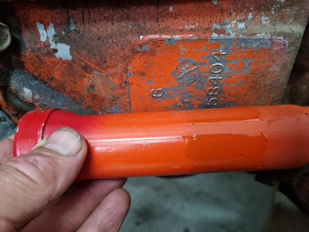

I have now done some samples of the KBS Rocket Red and some comparisons of this paint to the Duplicolor Paint Cans and also my original paint 327 Engine. The outcome is no real surprise, I have tried to photograph all of these colour in the best light situation to show the shades, but from my point the Duplicolor Chevrolet Orange still looks to be the closest match
Below is a sample board of the four colours, the two top colours are the Duplicolor Chevrolet Orange at the top followed by the Duplicolour Chevrolet Orange Red underneath, then the third one down is the KBS Rocket Red which is the same colour as the Duplicolor Chevrolet Orange Red and then the bottom colour is what is advertised on ebay as X2 Red.
Below is the paint can from KBS known as Rocket Red

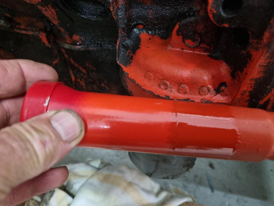

I have added below a few pictures of my bellhousing, the first picture shows a KBS Rocket Red and Duplicolor Chevrolet Orange Comparison
The rest of these photographs are of my oil pump housing, various angles and colours, but looking at it in person the chevrolet Orange is the closest.
The final photo below is of the head, again Chevy orange vs Rocket Red
I would say that if anyone painted their GTS 327 engines Duplicolour Chevrolet Orange, Duplicolour Chevrolet Orange Red, or KBS Rocket Red everyone would have a hard time seeing the difference, unless they were side by side.

#18 Posted : Friday, 5 July 2024 11:47:48 PM(UTC)
If anyone's interested.
I had my type.2 327 paint colour matched and they got it spot-on.
My bellhousing still had plenty of good original paint applied by McKinnon Industries in the later half of 1968.
Also found a good sample area on the original 68 date coded harmonic ballancer, and most of the timing cover had original paint in near mint condition also.
This late 68 McKinnon red colour is far redder (if that's a word) than DE1620 and no match to Dupli-color DE1607.
As for the X2 and the Rocket-Red on the 1968 Dulon G.M.H colour advisory page?
Nope, no match to either of them, and not close. Dont know how accurate those sheets really were.
So anyway I'm now convinced there were at least two, and more than likely many different GM engine reds.
Get your original bits colour matched.
I'm calling it McKinnon RED.
Wayne
