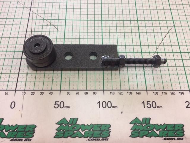

What I really need help with, is does anyone on here live anywhere near a mower wrecker? There is a part I need that farmer Joe has removed off this one and it is NLA as a new part.
One photo is the new part, the other is on a machine. It is obviously a chain tensioner.
I can buy the bearings for it (the roller is 2 x 6002DDU bearings) if I can find a used one off a wrecked mower. Only used from about 2009 onwards on Fastcut32 and Fastcut34.
There is another part that goes behind the steel frame that is just a rectangular plate with 2 bolts welded to it, the bolt ends are what the 2 nuts screw to. Undo them and there is a slot under the adjuster that allows you to screw it towards the chain to tension it.
Hoping to find a mower wrecker with one of these. Part numbers were GT22943 for the chain adjuster and GT22470 for the retainer that goes at the back of the slot.
Damn pain is they sold the last one in existence at the supplier a few days ago. An old Greenfield dealer may still have one in stock but I haven't found one yet with one.

If you can't find one, looks like the sort of thing that you could replicate fairly easily with a bit of plate some bolts and a welder?

That’s the next step if I can’t find a used one.

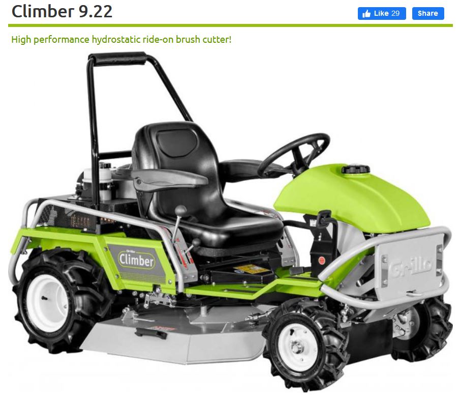

I had an old greenfield a few years ago and it was dangerous on my slopes.
The forward and reverse was controlled by a single tilting pedal and that might be a good idea for lawn mowing by no good at all for slashing my hill sides.
After the greenfield tipped and almost landed on me I sold it and bought a Grillo Climber 9.22
Hydrostatic drive with a diff-lock pedal, 22HP V-twin vanguard engine, low centre of gravity, agri tyres, its a ride-on slasher designed for steep slopes and its brilliant.
After my near miss I didnt care how much I spent so $16,000 later and 10-years down the track it is the only machine for the job at my place.
