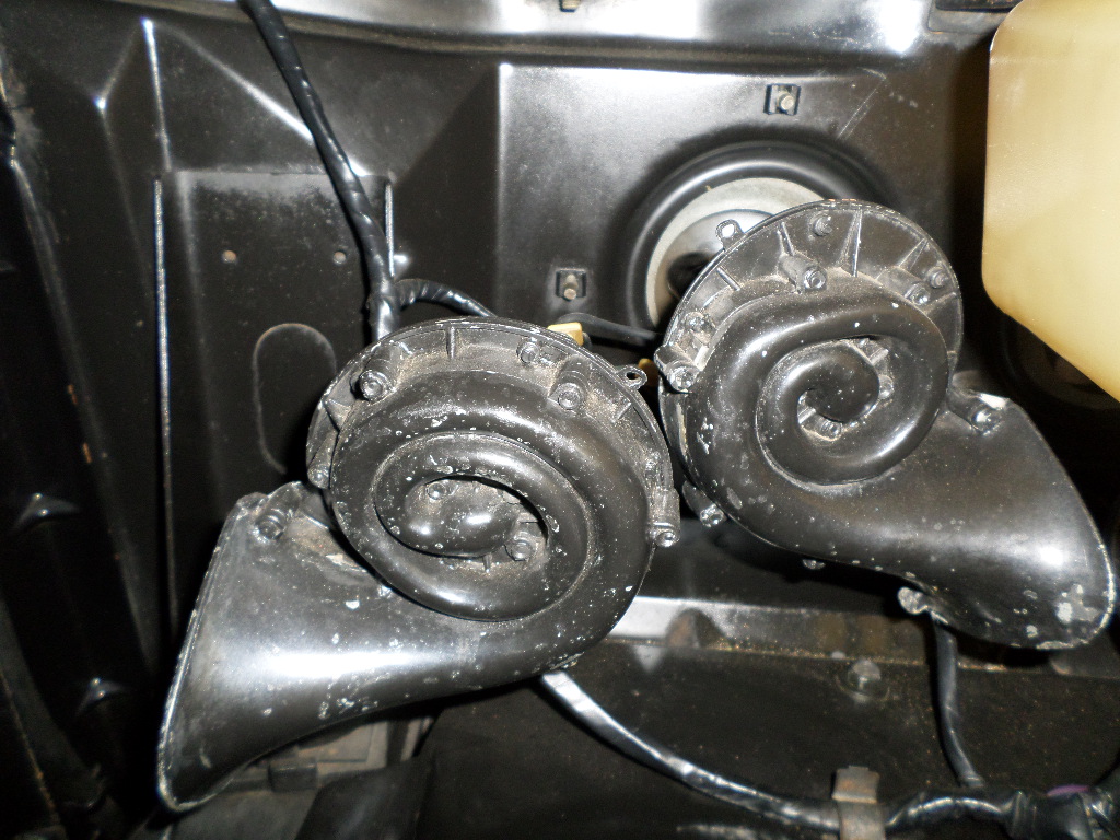

LS350 Offline
#6 Posted : Thursday, 5 August 2021 2:49:18 PM(UTC)
LS350
Joined: 13/08/2016(UTC)
Posts: 46
Thanks: 11 times
these photos may help
 1 user thanked LS350 for this useful post.
AC on 5/08/2021(UTC)
AC Offline
#7 Posted : Thursday, 5 August 2021 4:41:31 PM(UTC)
AC
Joined: 24/01/2021(UTC)
Posts: 58
Thanks: 54 times
That is brilliant LS350. Very helpful!
