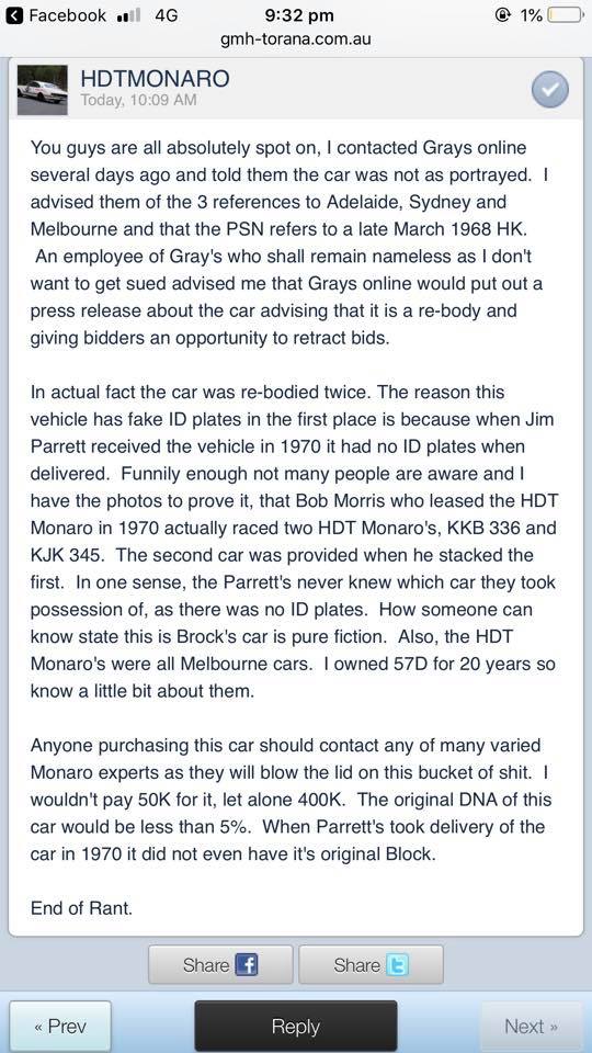

From GMH-Torana:
You guys are all absolutely spot on, I contacted Grays online several days ago and told them the car was not as portrayed. I advised them of the 3 references to Adelaide, Sydney and Melbourne and that the PSN refers to a late March 1968 HK. An employee of Gray's who shall remain nameless as I don't want to get sued advised me that Grays online would put out a press release about the car advising that it is a re-body and giving bidders an opportunity to retract bids.
In actual fact the car was re-bodied twice. The reason this vehicle has fake ID plates in the first place is because when Jim Parrett received the vehicle in 1970 it had no ID plates when delivered. Funnily enough not many people are aware and I have the photos to prove it, that Bob Morris who leased the HDT Monaro in 1970 actually raced two HDT Monaro's, KKB 336 and KJK 345. The second car was provided when he stacked the first. In one sense, the Parrett's never knew which car they took possession of, as there was no ID plates. How someone can know state this is Brock's car is pure fiction. Also, the HDT Monaro's were all Melbourne cars. I owned 57D for 20 years so know a little bit about them.
Anyone purchasing this car should contact any of many varied Monaro experts as they will blow the lid on this bucket of shit. I wouldn't pay 50K for it, let alone 400K. The original DNA of this car would be less than 5%. When Parrett's took delivery of the car in 1970 it did not even have it's original Block.
#16 Posted : Thursday, 26 September 2019 12:45:16 AM(UTC)
From GMH-Torana:
Yeah I saw that too.
Its a lot of money for a question mark car
