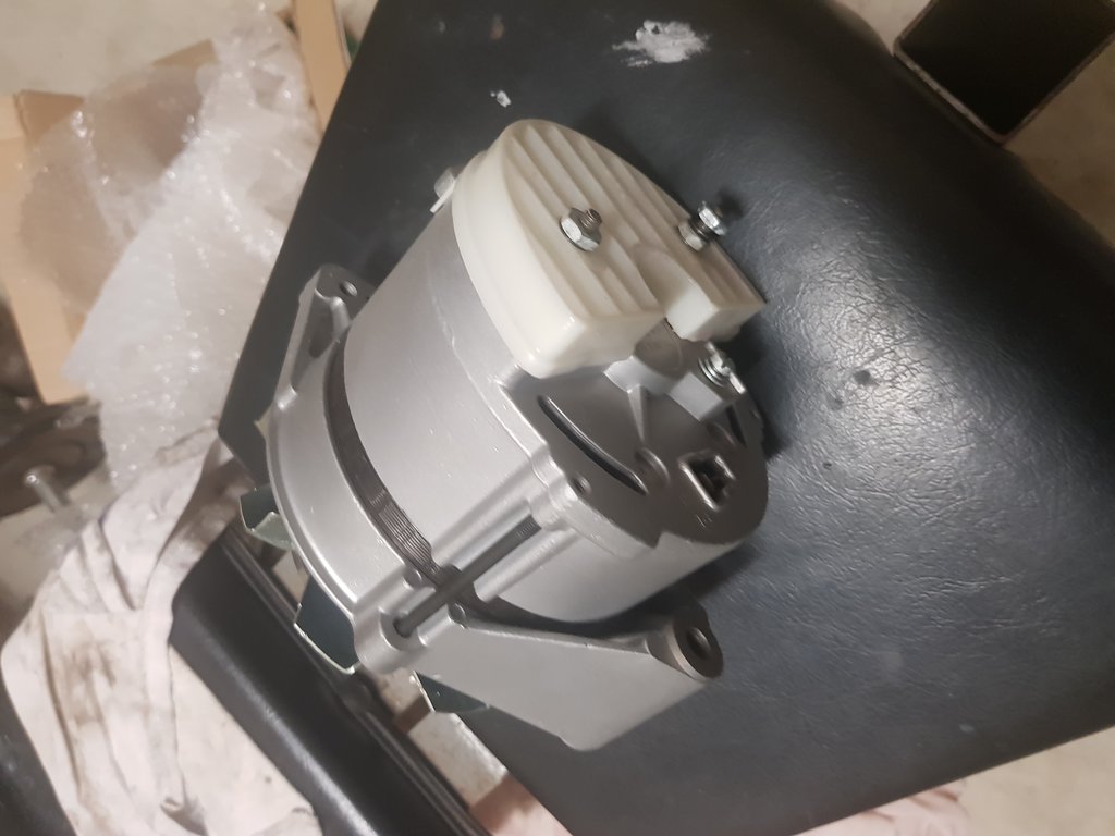

camaroTT400 Offline
#12 Posted : Wednesday, 28 November 2018 10:18:49 PM(UTC)
camaroTT400
Joined: 23/07/2016(UTC)
Posts: 20
Location: adelaide
Thanks: 12 times
Im pretty sure the fan itself should have 199 stamped on the back of it and the alternator belt adjusting bolt on the front housing is actually offset about 5mm if that makes sense. Will try to upload pictures

camaroTT400 Offline
#13 Posted : Wednesday, 28 November 2018 11:01:03 PM(UTC)
camaroTT400
Posts: 20
Location: adelaide
Thanks: 12 times

TT400, that alternator shows lots of clues, the shallow dish of the later pulley, the different fan and the white rear cage or grille.
I'm thinking the white grille is the same molding as the regular black one and is used as a quick identifier on the assembly line during engine dress, anyone confirm?
Im wondering if the fan hub area is different, and we cant see it hidden behind the 3inch pulley?
Keen to know the difference between the front housings, do you mean the offset of the pinch bolt tapping and how it is eccentric to the casting boss in your photo or some other area?
I dont suppose that alternator is burning a hole in your pocket? Looks perfect, what did it come off?

camaroTT400 Offline
#18 Posted : Thursday, 29 November 2018 4:21:03 PM(UTC)
camaroTT400
Posts: 20
Location: adelaide
Thanks: 12 times
Hi Abi i built this alternator because the previous owner of the car had the original alternator chromed. So i had new pulleys machined up and got some plastic grilles made in the correct colour. Im pretty sure the correct fan can be found on any v8 ktg alternator. Also the positive terminals must be swapped around because they come close to the rocker cover. I was going to build a few more because i had spare pulleys and plastic grilles made up just havent had a chance
