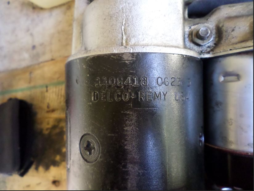

Originally Posted by: LS350 Go to Quoted Post
First photo is the original starter on our 6/71 ls 350 it's build date is July 23 1970 .(delco remy)
Second photo starter fitted,had on going issues with starter motor when hot,starter would not work no solenoid clip nothing.
Installed a temp heat shield cloth around the solenoid only and it appear's to have rectified it starts now when hot.
Next job is to remove starter and instal shield neatly around solenoid.
...had the exact same problem when used daily, but taken on a long trip in hot weather...used to have to reach under the car with a wet rag to cool the starter down, but jeeez, that was nearly 40 years ago !!

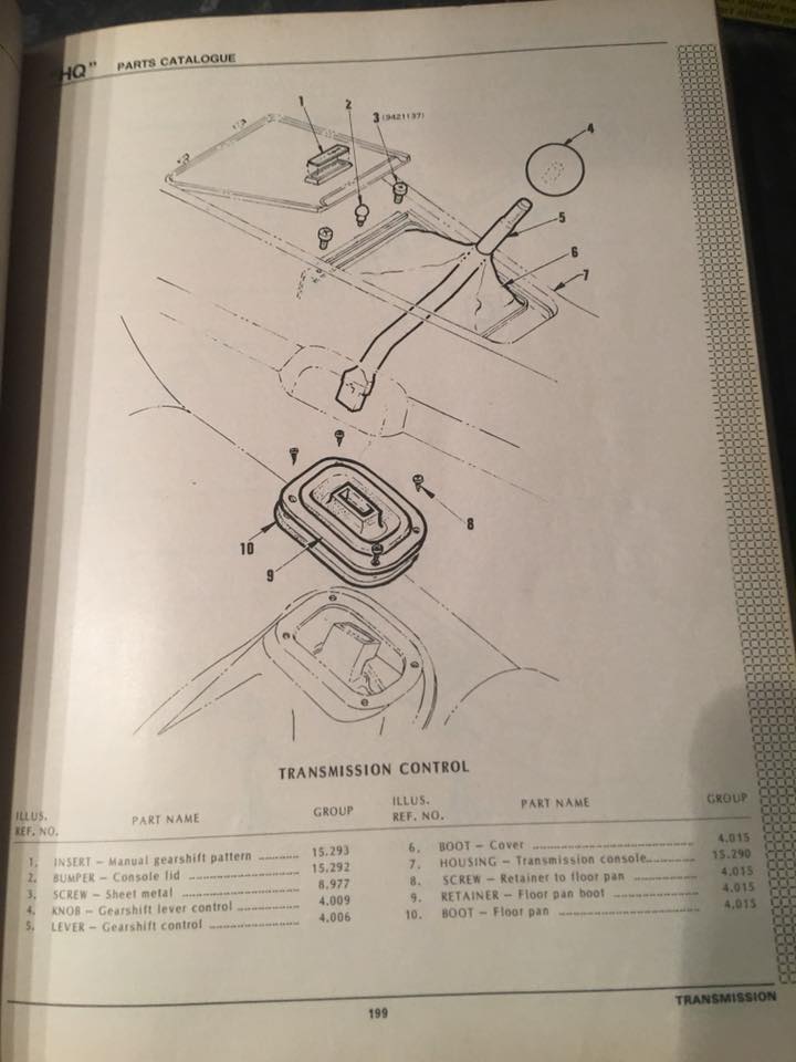

Originally Posted by: Allaboutthenumbers Go to Quoted Post
I thought the hump was welded to the tunnel, didn't realise it was screwed down.
...pretty sure about that, but other people will know. ??
