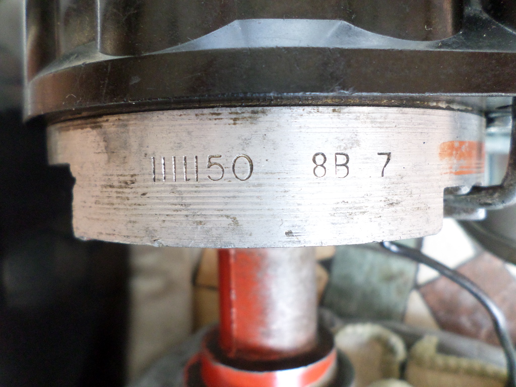

Pretty sure the dizzy is the same as most HK-HG with SBC design engine. 1111150. Specs are the same but for some reason those pre 1973 HQ’s are listed as 11111500 in the HQ service manuals. Could never figure out the exact reason for the number change, I discussed this a bit in the article in one of the Just Holdens back issues. From memory the final HG 350 manual cars with the Canadian engine list the same dizzy but listed as 1111500 (one less 1), but still the same specs.

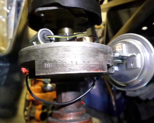

yes dissy is 1111500

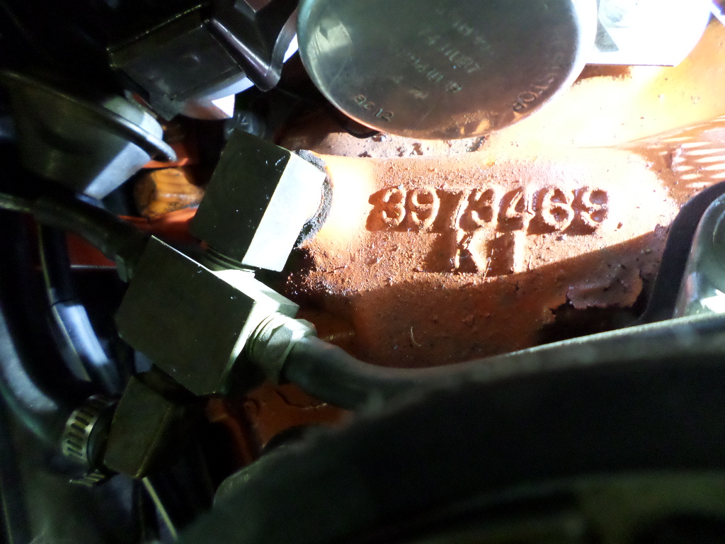

#8 Posted : Saturday, 25 August 2018 11:58:24 AM(UTC)
Unless total concours is your goal just use one off a 307. Same curves and looks the same, just one less 1 and the extra 0 on the HQ one!

LS350 Offline
#9 Posted : Saturday, 25 August 2018 12:46:06 PM(UTC)
LS350
Joined: 13/08/2016(UTC)
Posts: 46
Thanks: 11 times
#10 Posted : Saturday, 25 August 2018 2:32:09 PM(UTC)
That’s the one, easy to find as common to all HK-HG except the last HG manuals and IIRC the 1968 Impala and Parisienne. Lots in the USA too, off 1968 L73 and there were huge amounts of them made.
manifold is right 3973469 with K1 to ?
have not found date code on manifold but I will look closer today.
some people are selling K marked manifolds saying the fit HQ's but make sure on the pass/side there is only 2 bolt holes
in the centre were it bolt's to the head, not 4 as the extra 2 holes are for an A/C bracket.THe HQ's only used the head bolts for
this bracket.
Thanks for that, did not know about the extra 2 holes. Will keep this in mind.I thought there is a date code on the lower section behind the dizzy and in front of the part number.

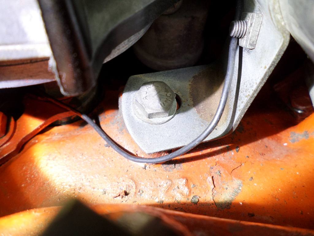

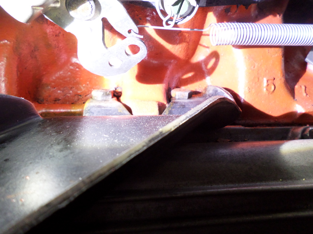

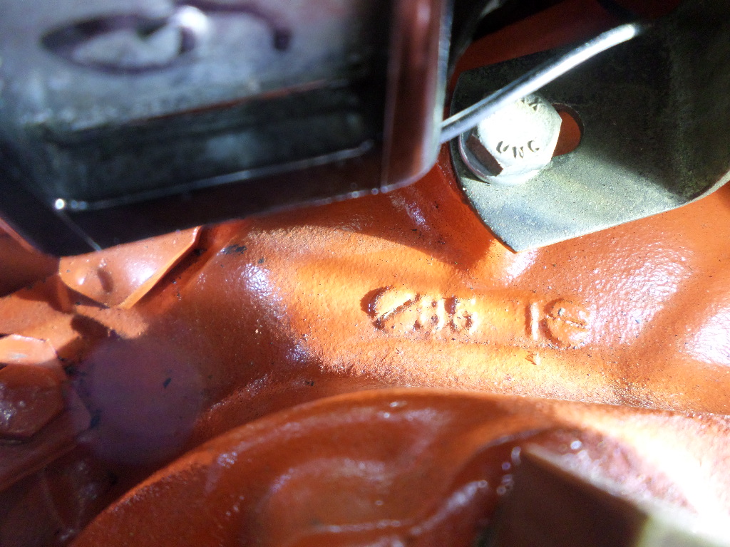

Will have a closer look but there is no casting date code it maybe stamped .
LS350 Offline
#14 Posted : Monday, 27 August 2018 11:07:11 AM(UTC)
LS350
Posts: 46
Thanks: 11 times

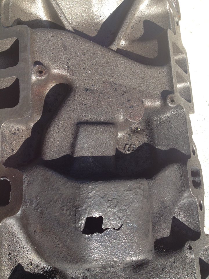

Found the date codes one is D 23 1 the other is B 5 1.If you locate a correct manifold check under the heat shield for holes in the exhaust passage.Itcan be repair but costly.

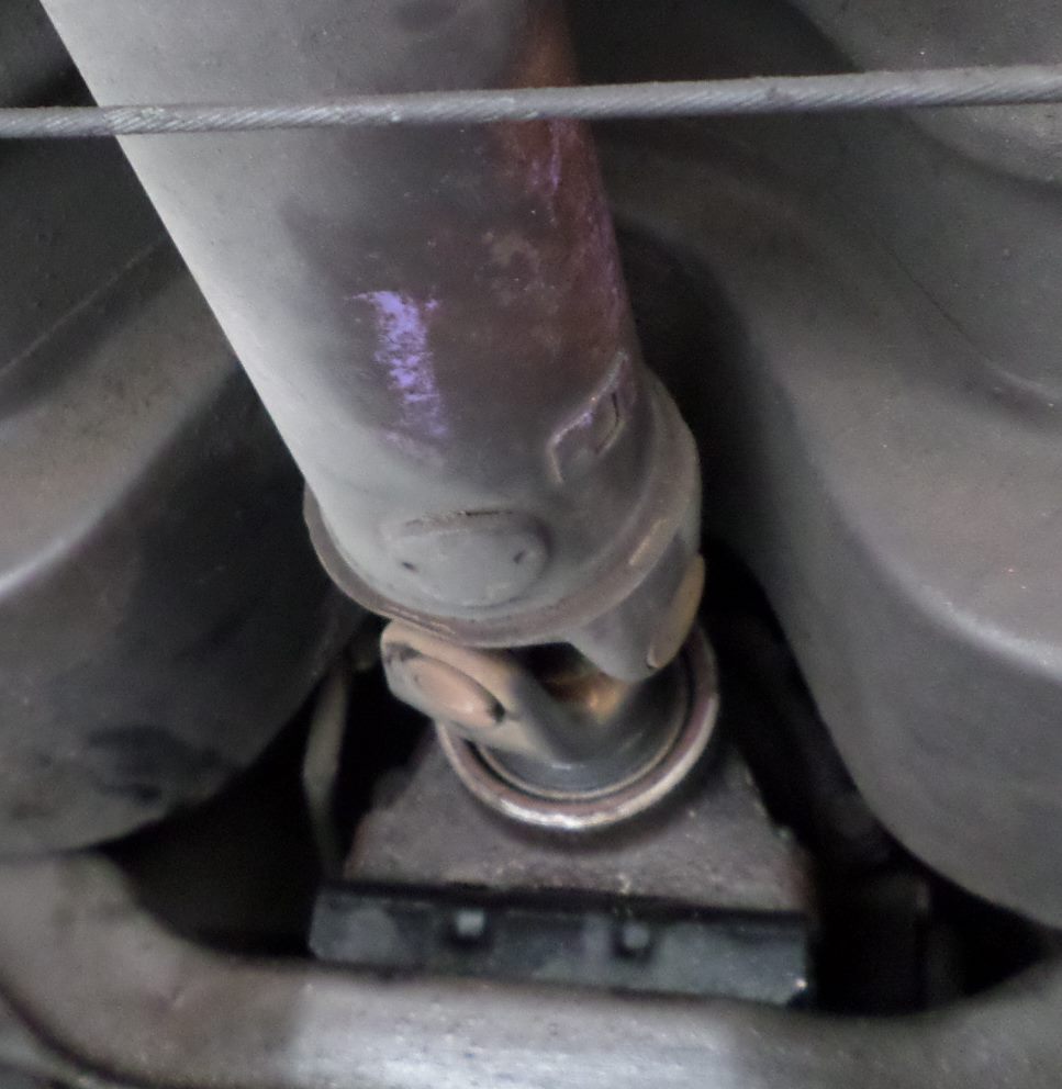

So next piece of the puzzle.... I need a tailshaft. My understanding is they were painted purple and possibly the same as a 1 tonne ute shaft?

Hi , not the same as 1 Tonner , they have 121' wheelbase , wagon/statesman /ute all 114' & sedan & 4 door all 111' . thanks Mark.
#18 Posted : Tuesday, 28 August 2018 3:36:01 PM(UTC)
Same uni joints though.

yes one tonner uni's and purple but paint is very poor looks like overspray

Thanks guys, so in short, any HQ sedan tailshaft with 1 tonne unis.
No difference between 6 and 8 sedan tailshaft, just uni joints?
