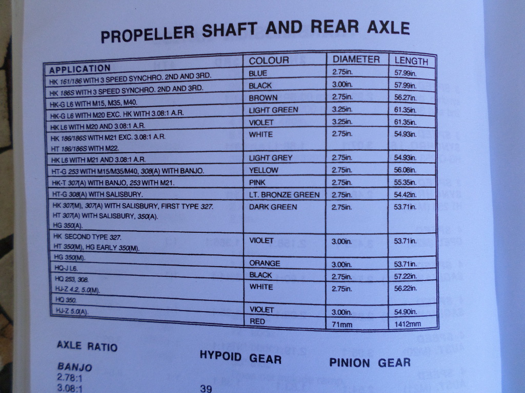

They are all different diameters, lengths, colours and unis. You need a HQ 350 sedan or coupe tailshaft. There should be around 1000 of them out there to find!

This table may help you.A HJ/Z V8 Auto (turbo 400) maybe your closest to the Hq 350 tailshaft.I have never seen a genuine one for sale to fit a coupe , a few statesman one's which you maybe able to shorten.

HJ to earlier HZ sedan and coupe 308 auto (TH400) does go close but diameter is smaller and the rear uni is the standard V8 size. All TH400 yokes use the bigger 1.125” uni so the front one is the same as a HQ350. As already stated you could shorten a Statesman with 350 shaft but not sure if the shaft looks the same as a sedan/coupe one. Best bet is to find an original HQ 350 sedan or coupe tailshaft or find one to copy- you will find the ends on a tonner shaft or on the gearbox end of any car with a TH400 which includes early VB Commodore 5.0L auto.

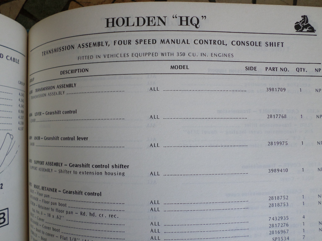

Anyone know if the Hurst shifter knob is same as Aussie?

I'm guessing they are different and rare as hens teeth

this is out of the 71 parts books.
Hope this helps you.

I have a stick that just needs bending to correct position and I have a mate with an original stick to copy but I don't have the knob and wonder if there is a repro one out there either from US or here.

What two digits does the part number start with?
#39 Posted : Wednesday, 12 September 2018 6:43:31 AM(UTC)
The Muncie gear knob is 2819975, while the Aussie 4-speed knobs are 2817736 & 2817737 for floor shift & console shift respectively. The Aussie gear knobs have a locking nut as well, which the Muncie section doesn't list.

#40 Posted : Wednesday, 12 September 2018 10:38:32 AM(UTC)
Almost certainly unique to Australia with that part number.
