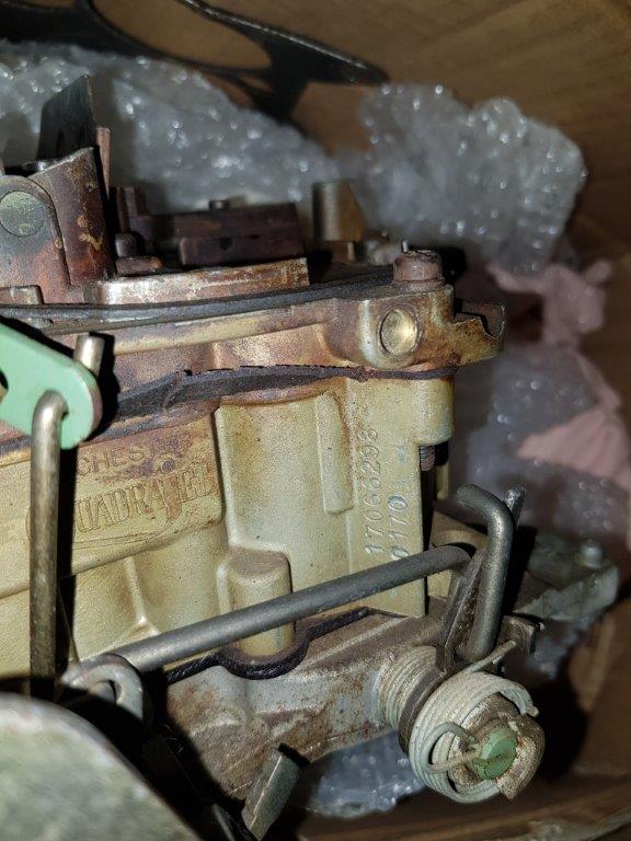

Need some help with the ID of a Rochester carby. ID number is 17066298. Date code 0170
4th number being a 6 does not match to anything in the on line reference material.
Anyone know what it came off? and when it was made?

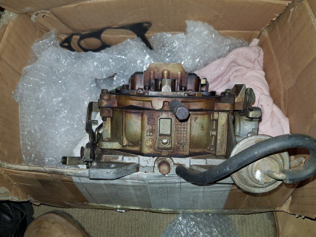

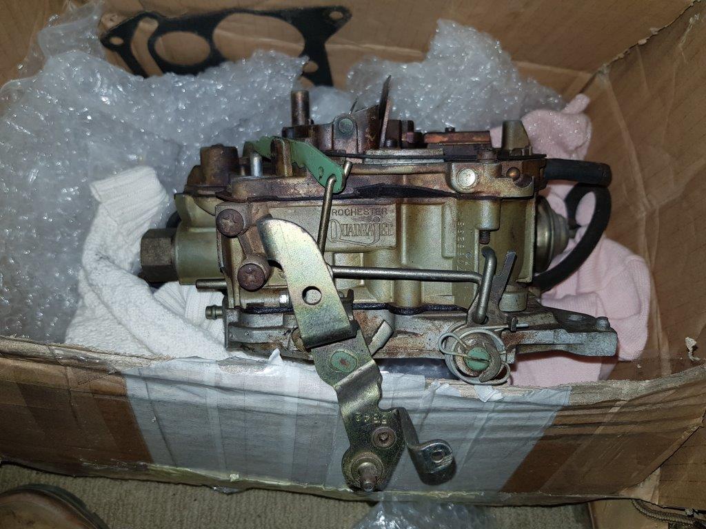

Carby 1
Carby 2
Carby 3
Carby 4
Carby 5

#6 Posted : Friday, 6 July 2018 9:48:49 PM(UTC)
Not a Statesman carby if it has a 1706 number on it. Statesmans are all either 704, or 1705. 1706 is not a carby number on a GMH vehicle. It might be a part number, but not an original fitment carby number, ie the number stamped onto the number pad.
GMH didn't have 9 on their Quadrajets for the manufacturer digit until the HZ carbs, prior to that they were all 8 except for the two engines with Chevrolet spec carbs on them (HK GTS327 with Chevrolet 327 and the ADR27 spec HQ 350 engines (8/73 on)).
If it doesn't have a code on it and it is some sort of replacement then it may be for a HX or HZ as these didn't have a code on them as there was only one carby for all applications (auto and manual the same). You can tell by the look of the carby if it is a red or blue type carby, they look very different.

After reading Balfizars extensive info i would say my carby is an 80's carby. The accelerator cable attachment arm has an extra side piece. Possibly for attachment of a cruise control mechanism.
The idle mixture adjusters are recessed into the main body as well. looks like a special tool is needed to make any adjustments.
Thanks again for the info and interested to see what else can be added from the pictures
#9 Posted : Saturday, 7 July 2018 12:04:16 PM(UTC)
It is a blue-black motor style carby, not a red engine carb.
The part number listed for blue 4.2 and 5.0L engines are respectively 17066297 and 17066295, so my guess is that is a spare part carby of some description as 17066298 is clearly a part number. If it was a production carby it would have a 17059595 CXK or 17059596 CXL on it. There is a 17059594 COC which I think is a late red carb but it has the earlier style body so it can't be a spare for that. It isn't a VK carby, these are 17110649 and 17111434 or VL which is 17111869, and the Group A versions will be later numbers of both.
