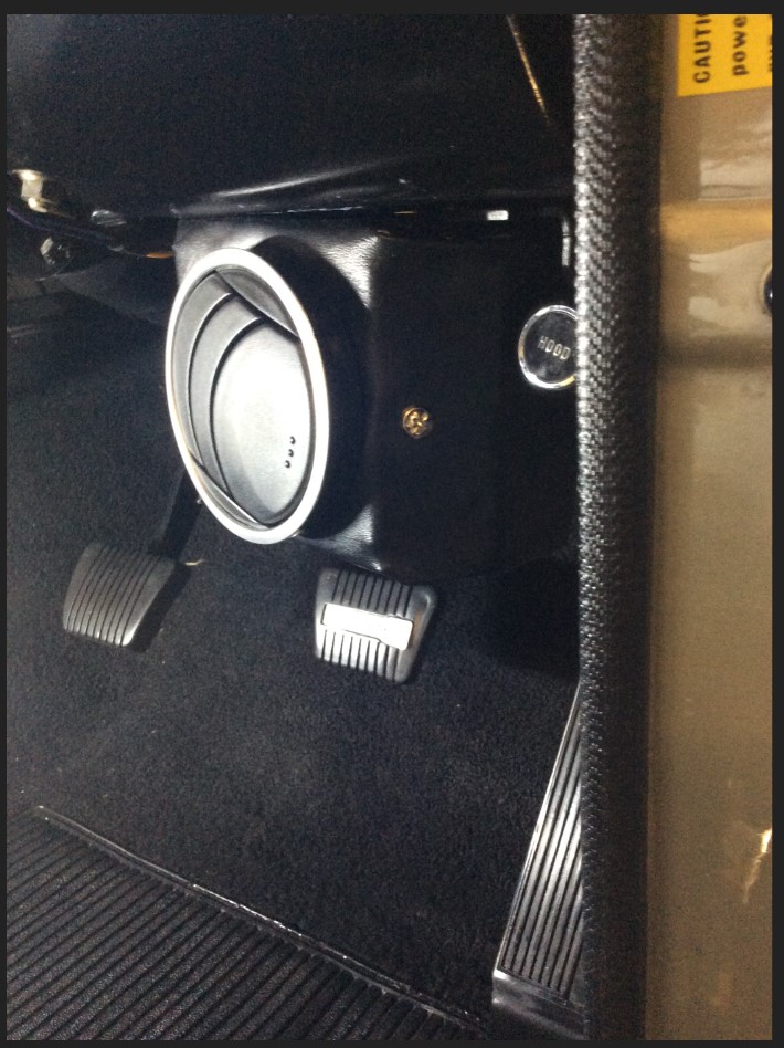

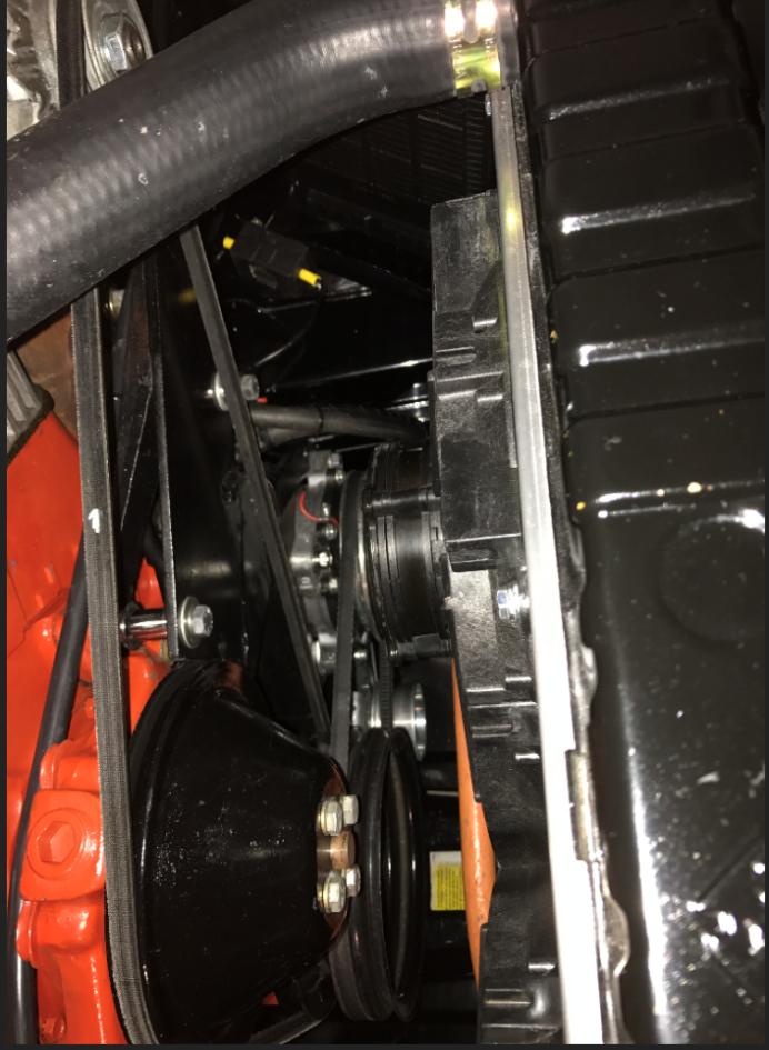

Here are some photos of the car since completion in December 2016. There are some photos of the mounting of the a/c compressor which is done using an alteration to a mounting bracket that was originally installed on a six cyclinder HZ. I couldn’t get one of the aftermarket mounting brackets to make the compressor stay where I needed it to be, even after modifying it. This setup is going well so far and I now run two drive belts on the compressor. Had to sacrifice most of the glove box space to allow the fitting of the vintage air unit as seen in the interior photos. Will get a dummy insert made up in place of the original glovebox compartment and also have the outlet nozzles properly upholstered.
