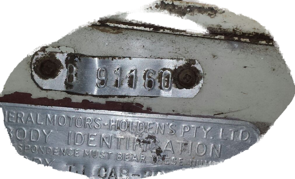

raffi4968 Offline
#18 Posted : Friday, 23 March 2018 7:09:07 PM(UTC)
raffi4968
Joined: 18/03/2018(UTC)
Posts: 19
Location: mackay
Hi HK1837 here is the other tag

#20 Posted : Saturday, 24 March 2018 2:02:57 PM(UTC)
Posts: 15,099
Was thanked: 630 time(s) in 593 post(s)
Originally Posted by: raffi4968 Go to Quoted Post
If it is an EH era build then this was assembled at the Valley Plant in (I think) Fortitude Valley in QLD. Body was probably built at Dandenong or Elizabeth.
As Geoff says some had 214ci engines (J1, J2 and J3), but yours is a J5 and if original and a petrol is a 300ci engine.
