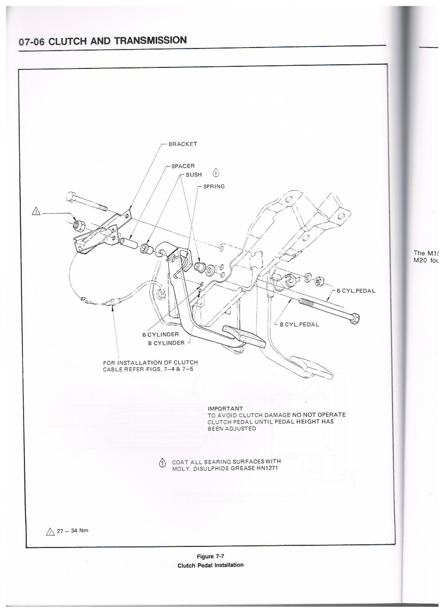

Haven't owned a WB in a while but have an original manual. Hope these help.
sorry about the one upside down i'm new at this photo stuff.
No mention of different hook length in manual.
