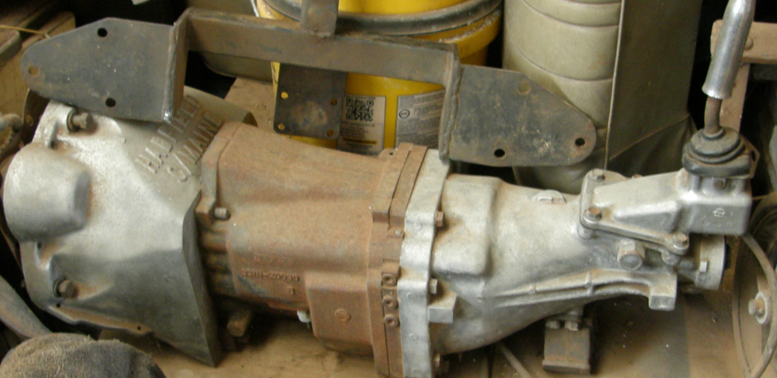

I've got a 4 speed box that has a hadfield bellhousing, clutch, flywheel, tail shaft and speedo cable that was behind a 186 that was in my van. I was told it was a Toyota dyna box. Is the bell housing the same for the 5 speed?

After Byron's comment on the size of the dyna box I had to dig the box out.
It's nowhere near the size of a cruiser box so maybe it's just an old 4 speed.

That is a “Celica” 4spd. What is called W40 higher up in this thread.

Being a "Celica" box with the "kicked back" shifter explains why I had to replace the entire front floor pan. the original one was butchered to fit the shifter.
Anyone want a cheap 4 speed that'll fit with "minimal" fuss.
I've at least got the cross member and bell housing that'll fit something better.
