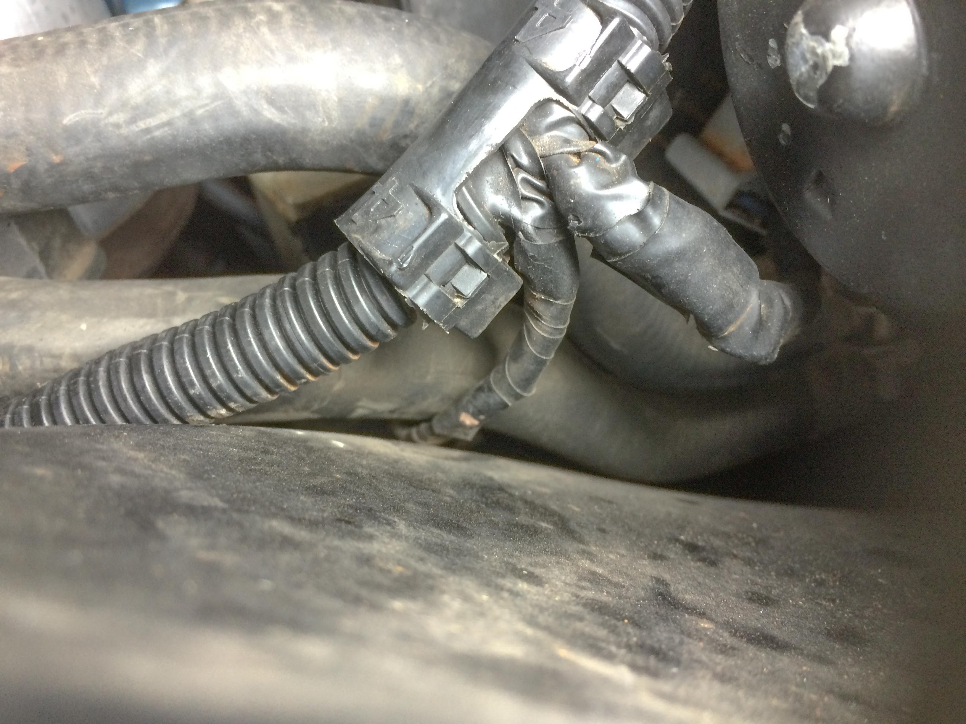

I was alway under the impression that the WB followed HQ-HZ factory air with the GM A6 with the STV to regulate temp.
Got my Oct 84 WB De Ville a/c going and it has a thermostat that makes the compressor cut in and out every 10sec or so. You can see a blue flash through the top of the thermostat as it does so.
I had a proper look today. It looks factory to me. (See pics). The second pic is where the thermostat wiring joins the loom.
Can you repair these things, or can I get a used one from a Commodore VH-VK? I want to keep it looking factory.
Also have feeble (cold) air coming out of the vents, and hot air when I floor it.
So I'm guessing that the vacuum pods are stuffed and maybe the heater valve playing up.
Oh well, almost there with nice aircon in the WB!

#2 Posted : Sunday, 8 May 2016 6:56:52 PM(UTC)
The vacuum servo will be stuffed as you said. Nice job to replace one of them, not.
Not sure on the thermostat but it looks the same as mine.

Getting back to ExportHolden's original question. Unlike HQ-HZ Frigidaire systems, which use an STV (Suction Throttling Valve), the WB system is similar to the VB-VC Harrison systems, which use a CCOT type valve & a regular thermostat to control the clutch cycling.
It sounds like your system is low on refrigerant. The fact that the thermostat is cycling so quickly is evidence of this. Make sure you have at least 950gm of gas (I am assuming R134a), otherwise the restrictor tube will freeze up & cause the thermostat to switch quickly.
