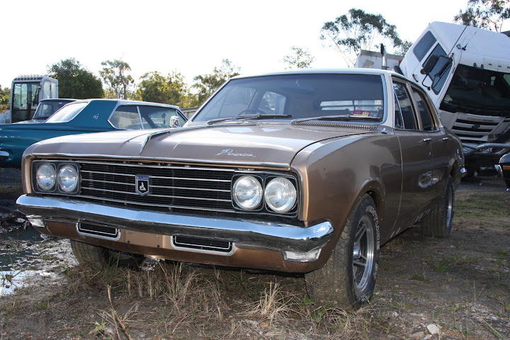

I've been on the forum know for about 6 months and I've never got around to posting pics of the G.
So because everyone here's put up with my stupid questions and helped with advice and, in some cases, some invaluable assistance, I thought I'd start a post and add some to it from time to time.
Bought the G from Brisbane in September 2009. It was almost complete and needed some finishing off prior to rego and cruising.
Of course, because of the length of time it had been sitting still since it's rebuild (almost 6 years) it was leaking fluids from everywhere and I had to pull the engine to fix it.
So since the engine's out.....
Anyway, this is how it was up in Brisvegas in September.
Stay tuned
