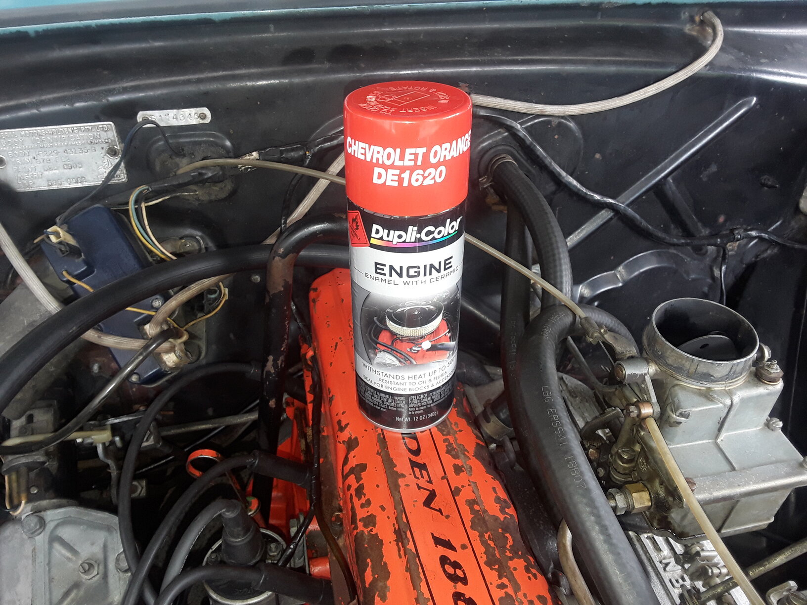

I'm back, with some interesting results 😊
The below 4 pictures are of my Sydney assembled 1967 Special Wagon.
They were taken with the Wagon outside, so plenty of natural light.
Taking into account 54 years of hot/cold/dirt/grime I would almost swear that Chevrolet Orange was the correct colour....if not, then extremely close.
These next 4 pictures, are of our friends Melbourne assembled 1966 Utility.
Unfortunately, it was tucked away inside the garage so only got the flash of my tablet.
In my opinion, it's almost certainly a different colour to the "Chevy Orange" thermo housing.
And therefore a different colour to my Special Wagon's engine...?
Perhaps the natural light gives my engine abit more "vibrancy", or the different assembly plant/assembly year make some sort of difference?
Both vehicles have between 100-110 thousand original miles, so reasonably even on that side of things.
Hopefully this provides abit of help 😎

What great information. Not that it's a revelation that Holden may have been painting engines in slightly different colours at different plants, wbut it does sort of reinforce the idea that Holden was possibly buying paint from local suppliers and not from a central source. It also seems that Holden was copying GM at the time regarding the bright orange engine colour for the performance engines, I.e. trying to get close to a Chevy Orange colour. This may be reinforced further by HK GTS 327 because it seems Pagewood had Chevrolet Orange or something very close on their 327 engines, and although unlikely it's possible that other plants may have painted their 327 engines a different red which I am trying to find out. I will have some more samples and original paint 186S comparisons this week for more references.

With this in mind, I went to the local Supercheap and picked up a can of Chevy Orange and to my amazement it was an all but exact match. That was where the mission started to find out if Chevy Orange was the same as Holden X2 Engine Red and here we are running this thread.
I am going to put it out there that based on the original paint example of my 327 and Dans 186 X2 that if anyone went down to their local Supercheap Auto and bought a can of Duplicolor Chevrolet Orange DE1620 and painted their engine then there would be no argument regarding the correct colour for their X2, HKGTS 327 and at this stage looks to be 186S.
I will some colour match comparison with KBS Coatings Rocket Red and Duplicolor Chevrolet Orange, get a few more examples of original paint motors and hopefully we will have some consensus.

That sounds pretty good to me 👍
What annoys me, is that it's proven my Premier X2 engine to be the incorrect colour, which I painted 4-5 years ago.
Might have to yank it out and throw some Chevy Orange over it 😊

don't.... it is not orange
found the sales brochure I got when I got my HD (yes, it was used but I knew the DP where i bought the car)
NOTHING orange about this... it supports my first comment on this thread X2 red is RED

Apparently one of the Duplicolor engine enamels either DE1607 or DE1620 is a very close match to GM Red Engine Enamel (Chevy orange)
I cant remember which one but looks like you're onto it.

The DE1607 is the red-orange and DE1620 is less red
I didnt use them.
