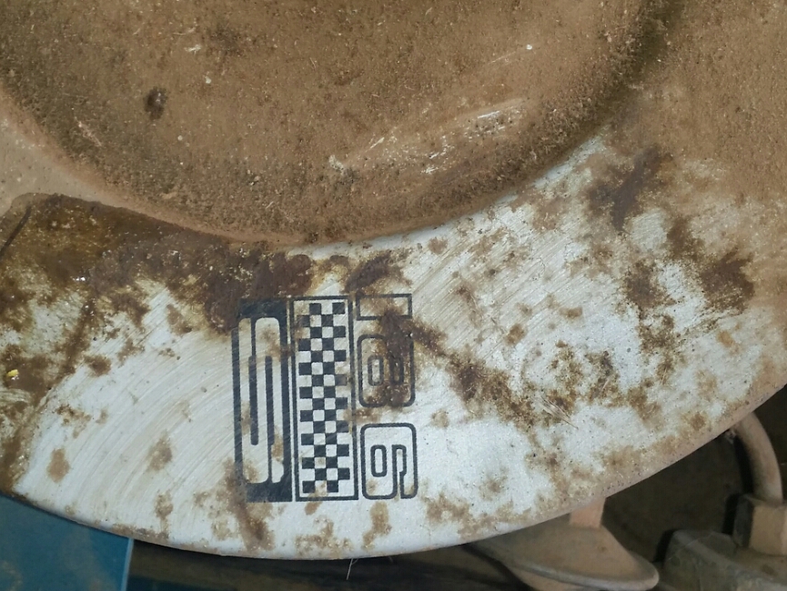

I have a photo of the air cleaner do no if it is the original anyone?
